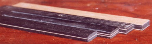

I'm trying to find a better way to cut my rosette tiles than a bandsaw. I'm toying around with buying one of the micro table saws, however I'm wondering if I can modify my table saw to do the job. Basically I need to use as thin a kerf blade as possible to save material from the tiles. I have the 6" fret cutting blade and stiffeners from LMI, however in order to use the blade for rosette tiles, I would have to remove the stiffeners. Would the 6" blade cut smooth and true or would there be too much flex in the blade? It would only need to cut through veneer sandwiches 8-9 mm thick. I'm thinking if I make a new throat plate for the saw, I might be able to use the LMI blade without the stiffeners. Any thoughts? If you dont recommend the LMI blade, are there any other alternatives out there for a thin kerf blade (< 1mm) on my table saw?

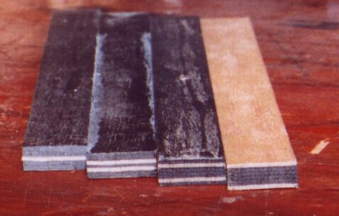

I don't think the pasta cutter will work. The way rosette tiles are made is 1.) glue up a bunch of veneer strips in the correct order of each row of tiles.
2.) Then each log gets a 1-2 mm strip cut lengthwise from each log.
3.) The strips are then glued together to make the final log which the tiles are cut from.
The Micro-mark tool may work, I'm just not sure if it can cut consistently at 10-12 mm thick through the epoxy glued veneer (it is pretty hard). I think my best option may still be an ultra fine kerf blade with some supports.
